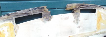

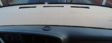

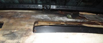

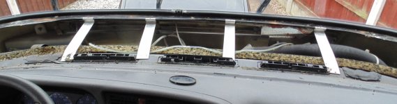

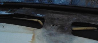

I had water running down the windows and onto the plywood cover for the Hymer dashboard, it rotted the plywood causing fumes and noise to enter the cab when driving, I have some pictures somewhere of the repair I did so I will post them when I find them, (Wintonian also did the same type of repair on his Hymer)
Here are the pictures, which show how important it is to keep the area dry. I couldn't see this rot because of the upholstered cover on top. The cover was lifting as we drove along, which should have triggered an alarm, but at first, there was no noise or smell.
All the acoustic soundproofing which was stuck underneath the plywood was replaced with new material
