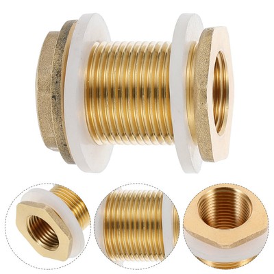

What I'd do is remove the centre drain completely and cover with a patch but before fitting the patch I'd fitt one like this in the side of the tank nr the bottom then fitt a pipe out to a tap at the side of the van.
