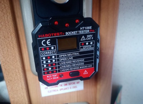

Did your plug in-tester not confirm the socket tests ok? It could be the indicator light that is the problem and not an actual fault?First trip out since fitting battery master, now find on hook up we have reverse polarity, sites checked out power post, not at fault, isolated all 240v appliances and sockets, none found faulty,
Removed the battery master as has it affected charging output on the Sargent?, I’m not sure, however with every thing off isolated and removed from power source we still have reverse polarity on sargent unit.

David thank you for your observations, I will obtain a Habotest plug in as recommended, and will check out our 328 as per your advice you’ve kindly listed. Image is sites tester in my socket, I will advise as able with results, kind regardsDid your plug in-tester not confirm the socket tests ok? It could be the indicator light that is the problem and not an actual fault?
don't have a tester and had to borrow one? why don't you have your own? A plug-in tester is a very basic bit of kit EVERY motorhome, campervan or caravan owner should carry and there is no excuse not to have your own one give they cost so little. Not only do they tell you about reversed polarity (important although ridiculously dismissed as unimportant by so many here it seems, so not going to discuss that further to closed ears), but also wiring faults with the earth cable as well.
I like the tester inthe photo below as not only do they have the simple warning lights, they also tell you the voltage. I leave mine plugged in 24/7, and only remove it if I want to use the socket. That way it is always visible and I don't have to hunt around for it when plugging into a new service to check.
tester by David, on Flickr

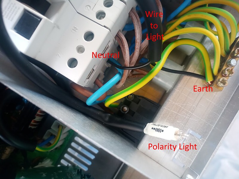

I don't really see how it can be a faulty EC328 apart from one specific thing (and that is extemely unlikely)
To explain, I just went and checked that my thinking was correct and that Sargent did what everyone else does .... They do on the EC325 unit I just looked at so I would be 99.999% sure the EC328 is identical.
Here is a photo of the inside of an EC325 ....
Polarity by David, on Flickr
The polarity light is the one that pushes into the bit of red plastic on the cover next to the charger switch.
The Breaker on the left where I have written 'Neutral' is the RCD - first port of call for the Hookup Lead inside the van.
The way the polarity light works is very simple - it is wired to the Neutral and the Earth. The only time it will light up is if there is live power on the Neutral (or on L & N instead of E & N).
So possibility 1 - that wire has become 'loose'and managed to relocate itself in the Live connection? rather unlikely.
This is the OUTPUT of the RCD, so:
Possibility 2 - the RCD has reversed the wiring internally? This is impossible.
Possibility 3 - the wiring INTO the RCD is reversed? could be, but a fault indication like this would not suddenly just show up
Possibility 4 - Something internal to the Unit has connected Live to Neutral? That could be a fault but I would expect a much bigger result than a plug-in tester showing reversed polarity. I would expect NO AC to work at the minimum.
To restate - the polarity light test is before anything exciting happens inside the Sargent EC box - the only component that it is connected to is the RCD.

Also, now apart from the Battery Master being the preferred device for Noahs Ark and best left there, it cannot cause an AC Reversed Polarity issue.
