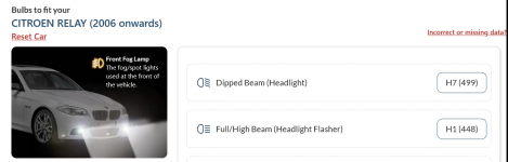

I doubt it very much. H4 is a combination Dipped/Main bulb, but is really only used when the headlight housing has just the one bulb in it (ignoring side light bulb). I think you have the same Ducato as me with the big curvy lights? in which case it is one bulb for dipped on the outside and one bulb for main beam on the inside - and they will be an H1 and an H7.I've just had a look on the site David and I didn't realise that I had two head light bulb in each light is that correct and they say both mine are H4
