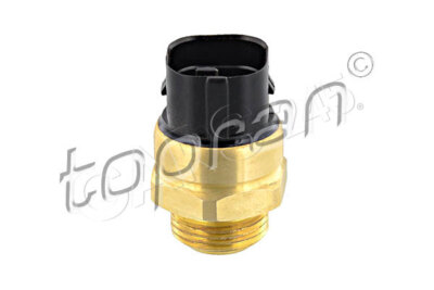

It should look something like this ..........
I think your pic shows the sensor for the glowplugs.

That's the fan switch that screws into the radiator sounds like the switch is knackered Marie ,we used to bridge out the wires to get home fan will run all the time and over cool the engine

Sorry, it is the thermoswitch, teach me to look at pics on a phone without enlarging them. Part number should be 701 959 481 or OE equivalent.
