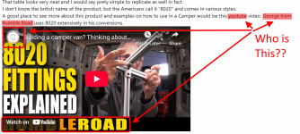

That table looks very neat and I would say prety simple to replicate as well in fact.
I don't know the british name of the product, but the Americans call it "8020" and comes in various styles.
A good place to see more about this product and examples on how to use in a Camper would be this youtube video. George from Humble Road uses 8020 extensively in his conversions.
Aalco have a massive range of aluminium extrusion may be worth a look. You will have to purchase 4 or 5 mtr sections though.
Aka Humble Road . YouTube
