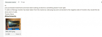

Inverter wiring
  • Thread starter Thread starter Deleted member 22093
  • Start date Start date
The one thing, that was mentioned, although not asked for but freely given, then ignored was the danger of the missing grommet.
