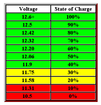

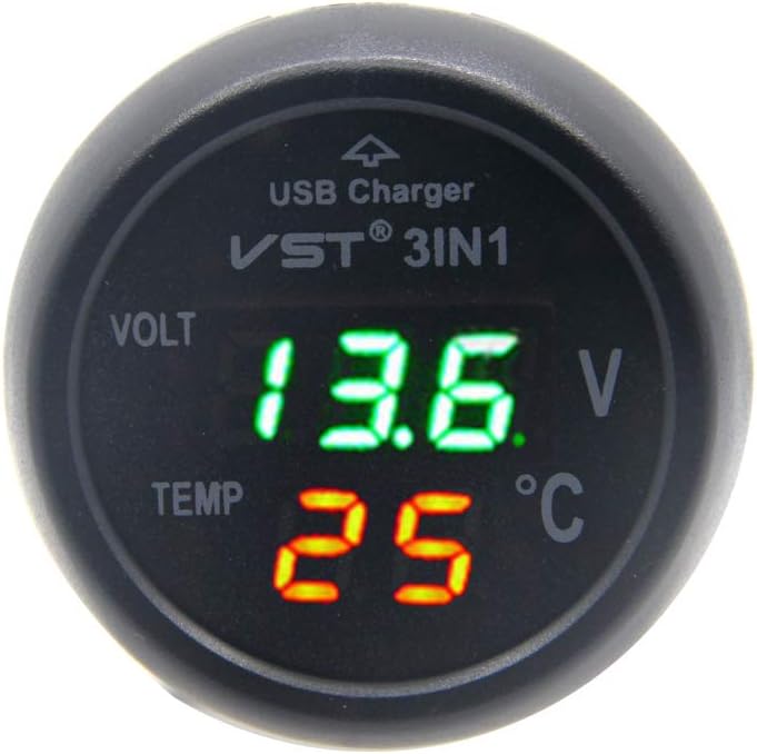

What you SHOULD get if it is not already there is a way to keep an eye on the battery level. This can be as simple as a Battery Voltage Meter. Not perfect but a lot better than nothing.
Something like this you can plug into a 12V socket and take a reading: https://amzn.to/3ceVffK
Then compare the voltage to this chart and you will get an approximate idea what your battery charge is
take a note when the engine has not been running for at least an hour or vehicle not plugged into hookup.

Batteries aren't all the same - some modern designs will be 50% discharged at 12.6v.
Try this Yuasa table that I've lifted from the site we can't link to.

Please note that the voltage is only an indication of the state of charge if the battery has had no charging AND no load for at least an hour.
This has been said earlier in the thread, but so many people overlook it, that it's really important to stress its importance.
If you notice your battery voltage is lower than you'd expect one evening, chances are you haven't been sitting in the dark for the last hour.

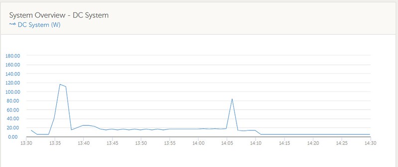

I'm not sure if "Far worse" is quite right? Compared to a Truma, there is a bigger start-up current and there is also an increased shutdown current, where I think the glowplug comes on and the fan accelerates to clean the combustion chamber, but apart from those times, the running current is fairly acceptable IMO.
This chart shows how much power my Diesel (actually Kerosene ) Heater uses on Starting, Running, and Shutting down. The line after that is the general power draw from the battery so that should be used as the baseline - (so remove around 4W/0.3A) from the values
Heater Running - Power
by David, on Flickr
Obviously the running line section would be longer usually. I did this as a test to capture the data.

So Startup hits 9A draw, running is around 1.2A (taking the baseline into account) and Shutdown has a rise to around 7.5A.
The Voltage drop was around 0.04V for the time the heater was in running mode compared to not running, so not that significant really, but then an additional current draw of 1.2A is not much. Over an extended period you would see that drop in a similar way to a Starter Battery just sitting maintaining "stuff"
