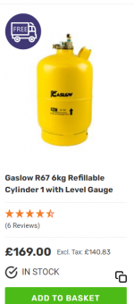

Is this refillable cylinder ok?
10,078
Not seen one like this before, I've been offered it at a good price but no good if I can't connect it to the existing system with 1 x 6kg Calor.
Not sure what else I'd need to have a remote fill through the locker wall it's a long time since I did one.
Yes it's refillable you will need to get a filler from a gallows or gasit dealer and a tail to connect it to your regulator.

No, the pictures are crap, I've not had to fit Gaslow only Gasit, and the top looked a bit more complicated.
these look similar, but it's a two bottle kit.

I did ask and he can't see a date, but they were new 2 years ago.
I've not seen on any forum since 2007 anyone actually replacing them though.
The date stamp should be on the collar (yours don’t have one) or the base ring. 2 years old sounds good.

I ended up buying new used ones were just too much and some had very little life left officially although I imagine they never get checked until something bad happens and the insur ance look for a way to escape paying out, so I'm good for ten years, good price too, I just forgot to get the French adaptor, no biggy.
The POL adaptor is on the bottle with the white tape on it, so you simply swap the one off the Calor back and forth as need be, I just hope I can find my Starrett hole saw kit.
