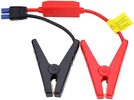

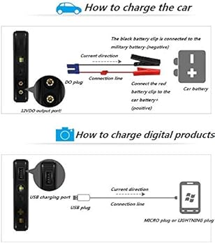

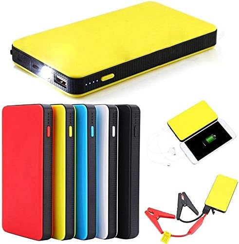

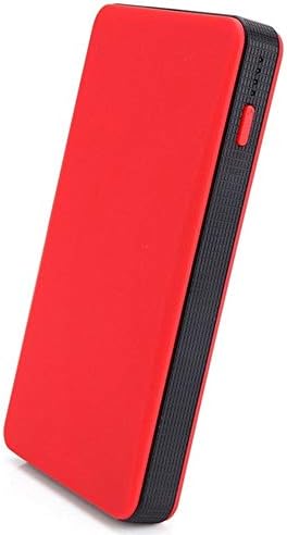

For the past 3 years I've been lugging around a set of heavy duty jump leads both for my peace-of-mind and my inner altruism. However I read today that if did what we did in my mis-spent (but fun) youth with our clapped out minis and escorts ie connect up, max revs on supply vehicle, then turn over receiving vehicle, I risk frying our ECU and we should just use the leads to trickle charge a dead/low battery. Firstly, this sounds sensible but is it true? And secondly, is a small jump starter like this at £39.99 a better solution:
Brand: Taotuo
3.9 out of 5 stars 71Reviews
Car Jump Starter, Portable 20000mAh 12V Power Bank Auto Car Battery Booster Power Pack with LED Flashlight, Quick Charge 3.0 USB Ports for Automotive, Motorcycle, Tractor Red​
  1. Car Jump Starter, Portable 20000mAh 12V Power Bank Auto Car Battery Booster Power Pack with LED Flashlight, Quick Charge 3.0 USB Ports for Automotive, Motorcycle, Tractor Red
Many Thanks
Mark
I have had one of these for 3 years, started numerous cars and a motorhome with ease.
Fortunately not yet had to use it on my motorhome but use it all the time to charge iPhone, iPad and ecigs and when my leisure battery failed used it to power tv for a few hours.
Got similar to these luckily not needed them my self but helped others a few times.
Just to mention before the usual they leads arn't heavy enough etc They are not jump leads just to quickly charge the flat battery
