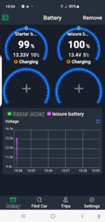

I have the same control panel, it's always out a volt or so, use a meter, or fit a decent battery monitor the BM6 is cheap enough and easy to fit.
https://amzn.eu/d/0e8vtXwr 1/2 price on AliExpress.
Good app on Bluetooth with 30 days of data download, I have two, the app can handle four.
