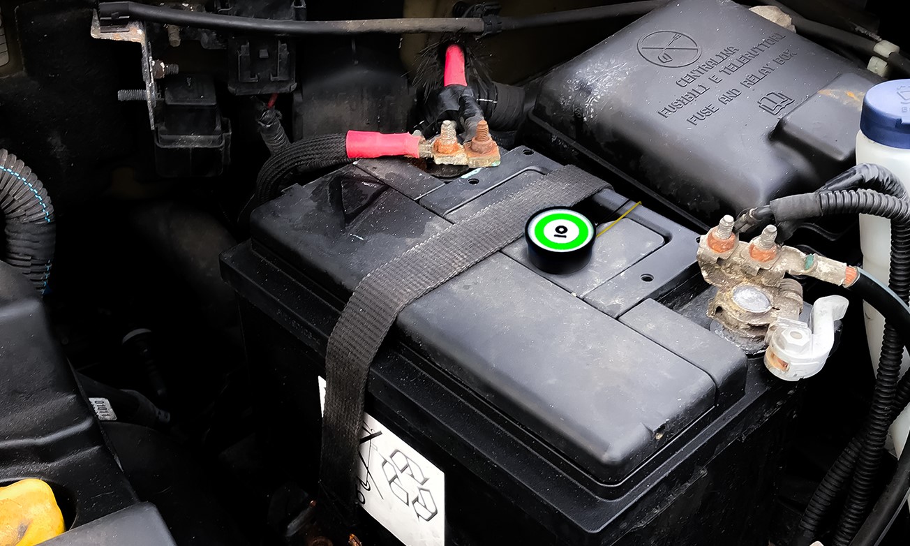

Looking for something like this:-
10,077
This is Bluetooth so not sure if I'm too far away to receive it on my phone, Wifi might be better but not found one yet, obviously it doesn't need to drain the VB too much.
I bought something similar to this a few years ago. As it's primarily a tracker it may be OTT for your purpose, but the app is very good and shows battery voltage. I've connected mine to LB but no reason why you can't use VB instead.

This might do if the BT can reach the 10 meters it states but surely if it's under the cab floor and also has to get through the cabs bodywork it wouldn't work.
My experience with Victron and BMS is that Bluetooth has extremely limited range outside the vehicle. I suspect that you would have issues with it.
The TruTrak device has not only cost of acquisition but also ongoing monthly cost of subscription. There used to be devices on the market such as https://www.nordmaxbattery.com/en/p...ttery-monitor-with-gsm-communication-_-741470 that worked on SMS and you could use a PAYG SIM to receive alerts direct to your phone, but it looks as though mobile data technology has replaced these with trackers with monthly subscription.

Yes, that looks good too, but I think it's too much tech for me, my mind just goes blank.
Yes Tom, I thought BT m ight be too limited in it's signal strength too.
The Nordmax thing looks about what I'd like, I think You're right, old tech, WiFi would be better as it cost nothing.
My victron solar controller is in the (ex) gas locker on the other side of the van, which is over ten metres from the house.
The bluetooth will just connect if I hold the phone near a window facing the van.
This is pretty rural, though. In a more electrically noisy environment it may be worse.
