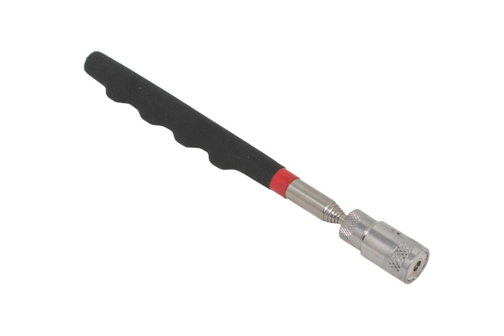

I'd certainly have a look at the bit above the visor, I'm thinking they will have needed to access it themselves. if you don't have one buy one of these.
