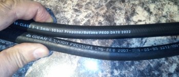

I noticed the other day that my LPG Pigtail Hose was cracking on the bend to the bottle connection and thought it best to replace for obvious reasons.
On removing the pigtail, I saw the manufacturing date was Feb 2007 - so 15 years old! Clearly this should have been replaced previously and I tried to find out just what the recommended (mandated?) maximum ages for the hoses are.

The hose was definately overdue for replacement .... Youcan see the cracking throughout the whole length
I cut the 2007 one in half and there is an inner hose that looked fine so there was no immediate concern of leaking.
The new one has a confusing date in a way - says "2022" which sounds like this year but I *think* the date is actually 20/22 - 20th week of this year as hoses are always stamped with week and month of production?
I double-checked the regulator and that is 2007 like the hose, which makes sense. I think I will get a replacement to at least keep as a spare.

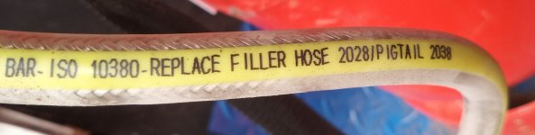

I took a photo of the Gaslow hose I got with the filler kit and those dates are interesting ... If used as a filler hose (which it is), it is ok until 2028; but as a pigtail hose it is good until 2038! (I wonder if it can be replaced in 2028 on the filler connection and then reployed as a pigtail for another 10 years?)
The filler hose has to cope with a far higher pressure than the pigtail, so that sort of makes some sense I suppose!
