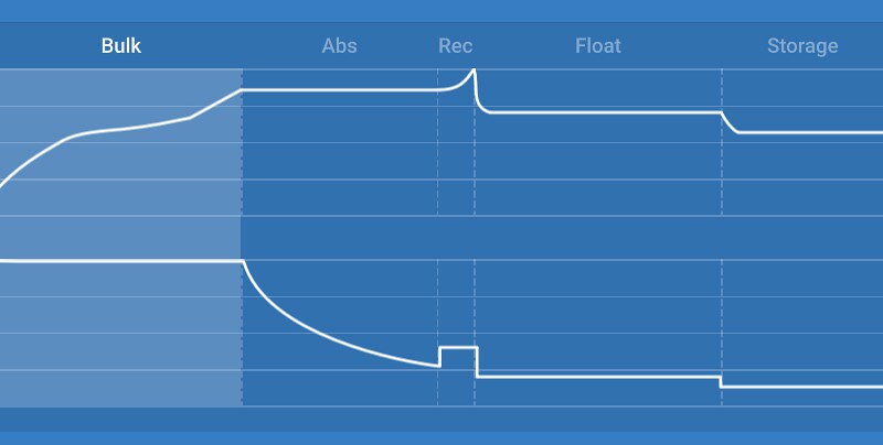

This diagram from Victron is a good representation of how a Smart (aka Multi-Stage) Charger (be it a Solar Charger OR a Mains Charger) works in terms of Voltage and Current
Victron Charging Scheme
by David, on Flickr
Top Part is Voltage (V) Level; Bottom Part is Current (A) into Battery. The "Rec" is recondition and will usually only happen if you specifically tell the charger to do this (I did have a charger that automatically did a recondition every 10th charge cycle, but that is not the norm)
I can witness my Charger (from Victron) doing precisely this pattern.
