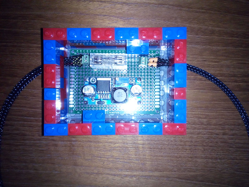

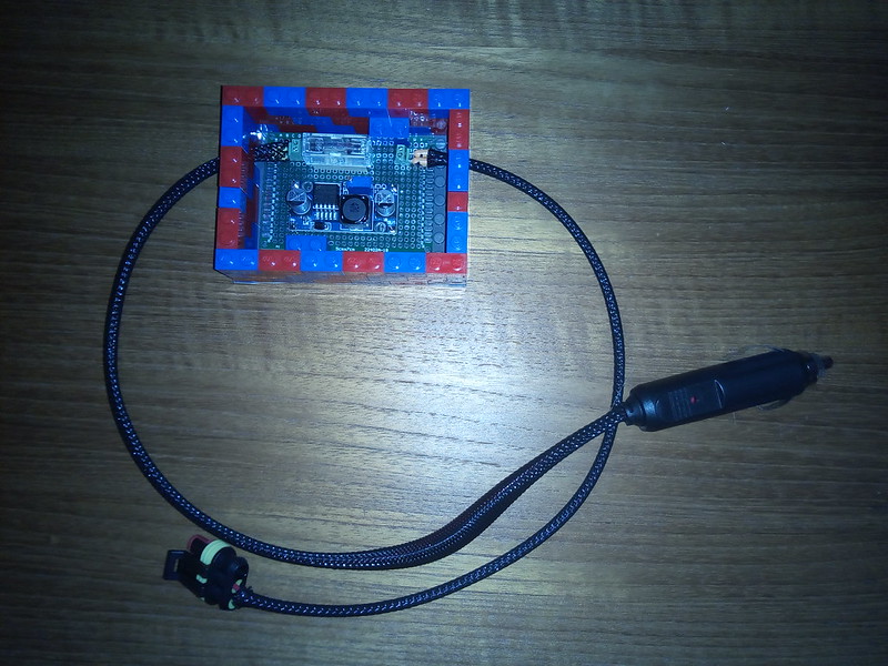

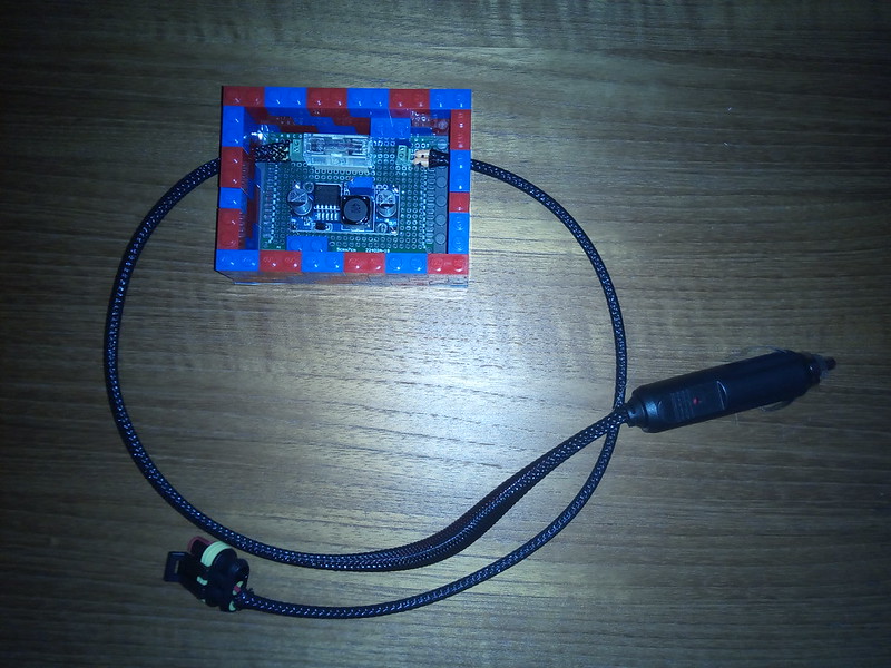

I built this one yesterday for my Echo Spot I just bought (it needs a 12V supply)
12V Regulator Box
by David, on Flickr
12V Reg board, plus fuse holder and a pair of screw terminals that I mounted on a PCB and built a lego box around it. Then 12V Accessory Plug one end and a multi-pin connector the other on flying leads.
Close up
by David, on Flickr
Cost a fair bit under £9.99 to build, but factoring in the amount of time it took, a ready-made one for £9.99 is actually much better value generally (unless your time is free, whch mine is for my own stuff of course).

PS. I used those multiway plugs so I can can cut the standard cable and then then easily switch between the DC supply or the supplied 240V AC Plug (I fit the same multiway to the 240V plug).
There are so many different jackplug standards around it is pot luck whether you get the right one or not (I usually end up with the wrong ones :( )
