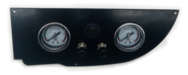

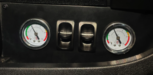

One thing I quite like the look of is this gauge mount for the Ducato, but looking at kits on eBay, it only features on the most expensive kits and not available as an individual item

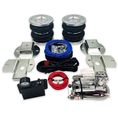

I see two possible options for the Martech for the Ducato
1) The "Comfort" Kit - £429
2) "Dual Control" Kit - £289
It looks like the difference between the two is the cheaper one has no compressor?
