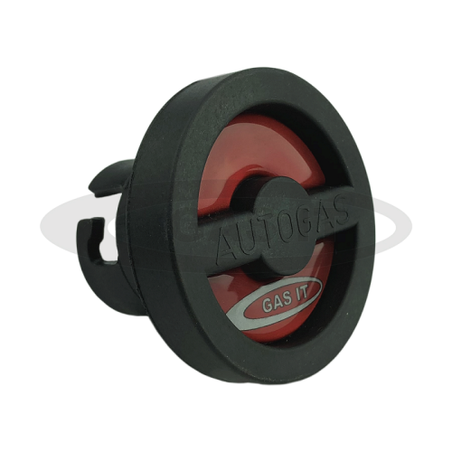

Is there a plug ?? available to plug the hole in the vans skirt if I remove the filler connection too ?

I recall seeing a blanking plug available for when a filler connection is removed on a Gasflow System, probably same available (or maybe same will fit?) on a Gasit?
