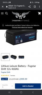

Going to go lithium this year now know what I need to do the job. So it’s a project later on in the year.
Does anyone have any feedback about these batteries.
Are they as good as any other or are there better about .
I was thinking 2 would do enough for the portable freezer 1 amp hour. The tv 24 amp hour water pump and the usual other stuff for at least a week

Portable freezer 1 amp hour? Are you sure on this? It is possible but rare?
TV 24 amp hour? Is this based on your average use per day?
Hard to really answer question with somewhat vague info.
You are thinking of a pair of 460Ah batteries? You need to consider how if you think you might need that much capacity, how you will recharge them.
