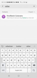

I paid £27 for our discontinued tray from Magnums, quite a lot of the build came from there or the place in Rotherham.
I got some stuff LW boardsetc from a place in Rother have as they were much cheaper but buggered if I can remember the name
Brain clicked into gear briefly & I checked my phone as I rang them to check stock.
01226753956
