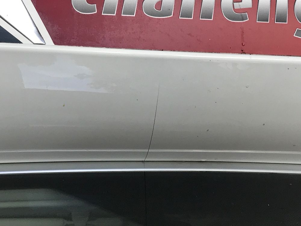

Thanks I shall look at those tonight. Here are 3 photos I hope they are clear enough to see the problem. I've previously tried repairing the first cracks with fibre glass matting and resin but it wasn't really satisfactory. Ignore the painting I know it doesn't match it is just temporary.

I'm no expert in these matters, but it certainly looks worrying due to the sheer length of the cracks.. Are you aware of any Challenger owners' association where you might be able to get advice if other owners have experienced the same issue? If you use Facebook (I don't), you might have a look at https://www.facebook.com/groups/176553652783707/

Polyester is a problem to fix, you could grind the crack and fill with aroldite then paint over with a 2 pack paint, you will have to use a acide etch primer.

Thanks again. I've found the group on FB and applied to join. The links you sent me yesterday relate it seems to a known problem with Challenger and Chausson that Trigano are away of but it is cracks appearing in the capucine section (the luton). I've yet to find anything on cracks at the rear end of the roof. As I think you can see on the photos the roof has lost its proper curved shape and the cracks run from left to right and not vertically.

The real question is whether this is in any way structural or relies on glass fibre reinforcement to retain some sort of shape. If there is delamination, simply preventing further water ingress may not be adequate. As well as car body repairers, you might consider boatyards that undertake GRP repairs - there should be some in the Charente Maritime..
