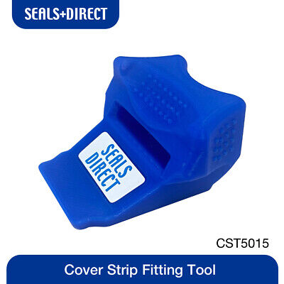

I've also ordered a fitting tool: yes of course it could be done without, but if I'm going to refresh all 4 windows then my time is worth the cost of the tool. It is also from flea bay, supplied by Seals Direct, but ironically is cheaper than if you bought from their site because they are doing zero cost delivery.

Top tip I read somewhere was to put masking tape either side and mark the position of the screw holes. I found the insertion tool not easy and managed without. I left an overlap at the joint for possible expansion in the future. I also started and finished under a fitting which made it neat and held it in place.

I noted earlier that one or two people thought the 'insertion tool' wasn't a lot of cop and did it without. My experience was a little better: I found it almost, but not entirely, completely useless. Actually that isn't quite true. I struggled to start with, then got a bit of a hang of it. I actually found the the way to get the best out of it was to use it get the new seal seated/inserted, then keep it held in place and use it to feed the strip through. And then when you reached the limit of what that could do, try and use it conventionally. Anyway, by the end I was finding I could most of the job with it (probably more silicone spray helps as well).

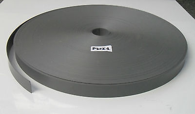

This is the link for the seal. Note that this is 23mm width. There are two standard sizes as far as I'm aware: 23mm and 25mm. So make sure you measure:
This was the ebay listing for sealsdirect's insertion tool (cheaper than buying direct from their website.....)
