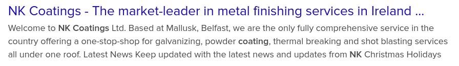

No idea as i did not work there, it was my biz partner terry who did, ther premissis was in Malusk just a mile from me, now its a galvo plant for N K Coatings.nk coatings.jpg
So basically your telling me all about powder coating but have no personal knowledge of it, despite me owing and running a company that specialised in do in high class work for critical customers, that's a bit like me telling you all about outboard motors and some little used operating system.
