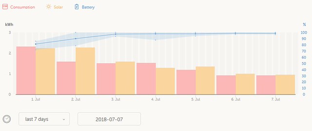

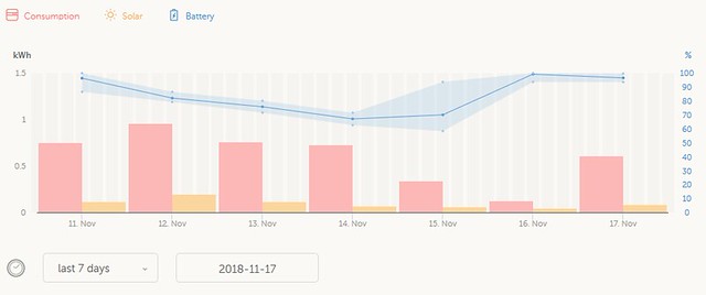

I thought I would post a little comparision to show the difference in the solar harvesting that can be expected at different times of year. My vehicle hasn't changed in terms of Batteries and Solar Panels (440Ah/400W) and the vehicle would have been parked in exactly the same place give or take a foot or so. (My parking location is not that good for solar, but that is true of the Summer as well as the Winter).
These charts show a seven day period of Solar Harvesting (Orange) and Consumption (Pink)
(the blue line shows the daily average battery SOC and the shading is the upper and lower SOC for the day)
So this month of November:
WinterSolar
by David, on Flickr
So in the week above the peak harvest provided about 16.5Ah for the entire day
Going back to July we see this chart:
SummerSolar
by David, on Flickr
The first 2 days we are getting in excess of 180Ah each day, and the only reason the other days have dropped is the batteries are already full by around midday so the solar harvesting will just be covering consumption demands and any excess wasted.
So a pretty dramatic difference between the two months there, with November being just 10% of the performance of July! Different areas of the country will be a bit different of course, and especially if in Southern Europe, but I think it shows attempting to rely on Solar in the winter is a tough ask.

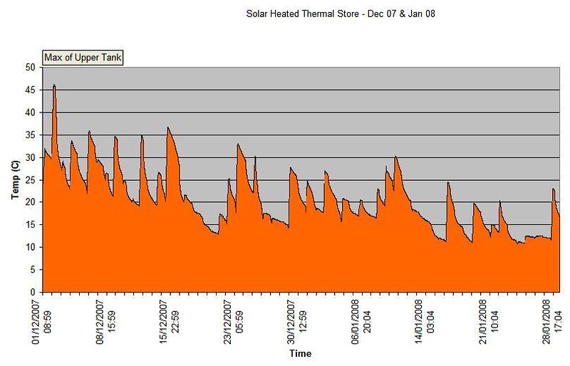

One of the biggest issues with Solar nowadays in the home is that all the shisters who used to sell Double Glazing moved into the Solar Energy Industry once DG became more regulated. I remember door knockers saying with the Solar DHW systems that you would have so much excess hot water you could feed your heating system with it! Yeah, right on that one.
I did install Solar DHW (actually a lot more efficient value wise than PV Panels a decade ago) with my own design setup and it WAS great - teamed it up with a specific european Combi-Boiler that accepted warm water feed-in (most UK market Combis didn't then) and the boiler wasn't needed for most of the summer - and in the winter, the energy it used was the same as a standard Combi in the summer with the pre-heated water in. I used to have a data logger on the system (surprise surprise!) and was able to calculate the ROI on the system to be under 5 years (a Solar PV system even today with cheaper panels and current tariff buy-back is typically measured in decades in terms of ROI)
Dec 08/Jan 09 was a cold time on the south coast and the mains water was very cold indeed. This is the water temp in the Thermal Store, heated solely by solar (and of course heat being used daily for showers, washing etc, so needing to be replenished)

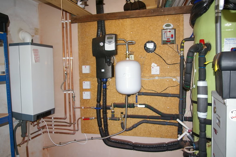

Solar DHW ... at the "doorstep" prices, it is very poor value I agree. I contacted a specialist company who installed the solar tubes and the pipework to the pump, then Pump to Store; but I installed all the rest - the Thermal Store, all the plumbing and the pipework upto the boiler tails myself.
Was well chuffed with the results I cannot deny. This was just after the Combi was fitted.
IMGP0496
by David, on Flickr
(I remember I used colored tywraps to make it easier to see what pipes went where - Blue is cold (mains), Red is Hot (to taps) and Green is Green Energy (solar heated)).
Thermal Store has coils for the Solar and the Rayburn (as a heat dump), plus an immersion as a "just in case" and the combi is fed through it. The various lever valves allow any part of the system to get shut off and bypassed and the various auto-valves means the Combi will only ever come on when the water is below a set temp (think 43C from memory? Something to do with legionnaires) and the water is never above 60C as the TMV will open to mix as required.
It wasn't a massively cheap system, but because I had to replace the old boiler anyway, redo the heating pipes and radiators; change or lose the hot water tank AND do something about the massive rayburn radiator heat-dump in the dining room, getting a system that was "solar DHW ready" added little to the cost, and the solar install itself was not expensive (nowhere close to the Doorstepper prices)
