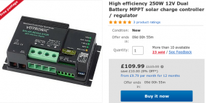

On our last trip our 12v electrics started to trip out. They did it randomly as in there was no set time of day that they went off and when reset sometimes they stayed on and other times they tripped again and again...
I contacted Sargent who suggested to unplug the solar regulator from the back of the EC500 Panel. I did this and it worked: no more tripping.
Now I need to replace my solar regulator.
It has a part number C12/24-10 on it but no make. I have tried Googling and it 'may' have been made by a company called Carspa but Google provides no sales outlets for it. So my questions are..
- Does anyone know the make and where I can get one from?
Or
- Could I swap this out for another make provided its 12/24v 10A? (I'd prefer not to do this option as there is a bracket that the duff one fits on so any new pattern wouldn't fit)
Ta muchly
Photo below is generic but it looks like mine...
