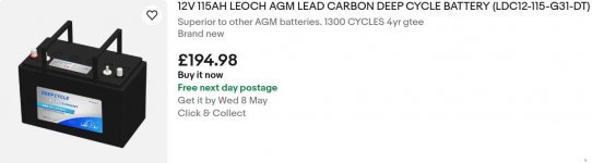

Buy a loach lead carbon battery and not a so called les battery which are glorified starter batteries, some may have thicker plates inside but old hat these days.
Some of these so called auto regulator/switch only bump in 13.7 ish volts, make sure you are getting the full monty 14.4 at least, mine is a manuel 200ah relay and switch, just have to remember to use it once started and turn of when stopped, cost about 8 bucks all in, battery under £200.lead carbon d.jpg
