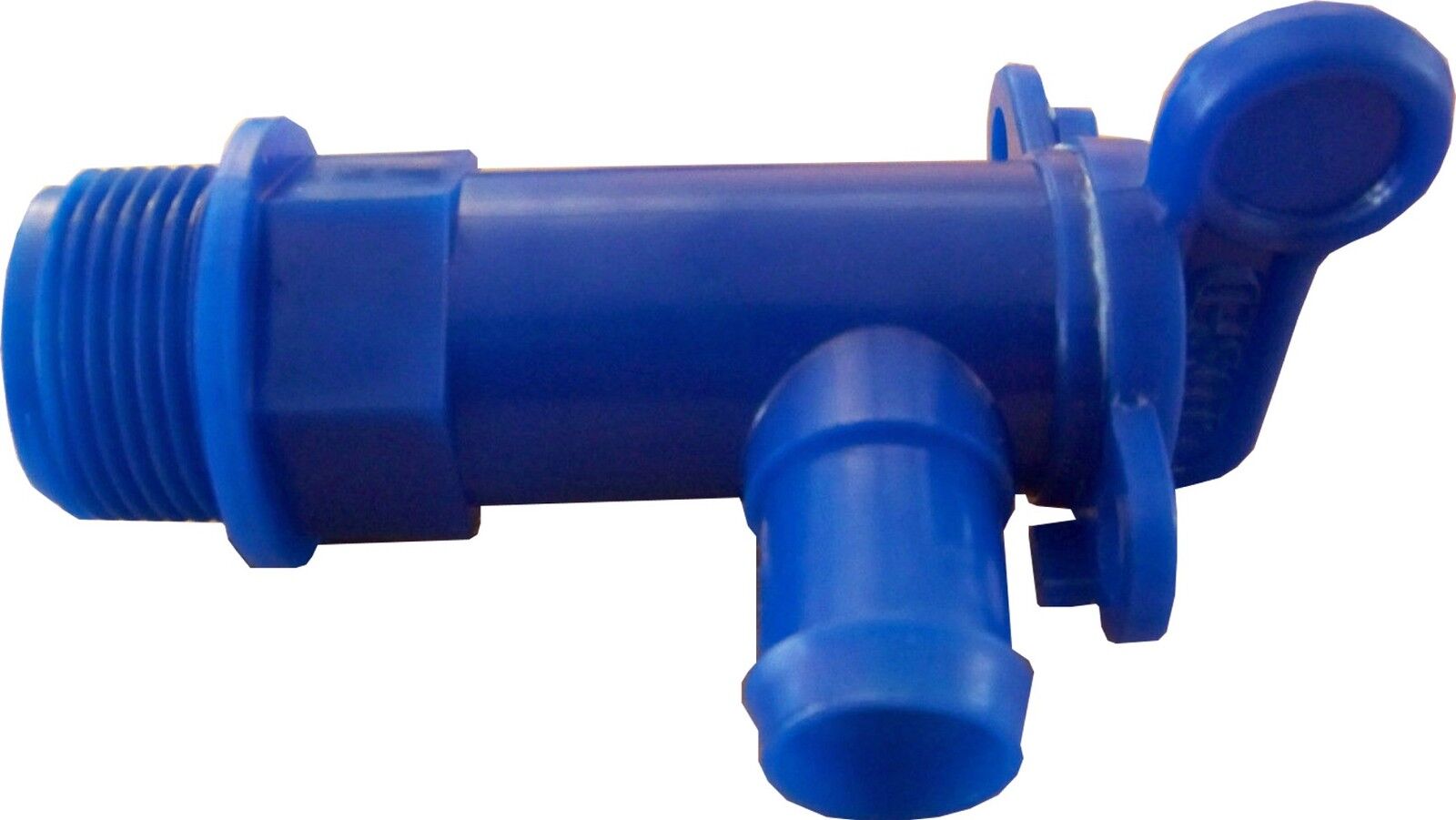

Yup send it back as not fit for purpose as it unscrews the backing nut, and get this type instead, where the rotation of the tap cannot affect the tightness of the fitting.
https://www.ebay.co.uk/itm/3-4-BSPM...=item33bebf7869:g:qpwAAOSwMgdX0WbA:rk:13:pf:0
https://www.ebay.co.uk/itm/3-4-BSPM...=item4b07ec306d:g:MSoAAOSwFV9X0WhL:rk:15:pf:0
https://www.ebay.co.uk/itm/water-bu...f03f5f63:m:ms0_jrdb6Q-iLMWellxdDJQ:rk:20:pf:0
Thanks. The top one looks ideal for the job :)

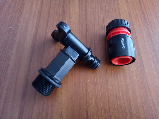

I got the replacement tap a few days ago
Grey Tap
by David, on Flickr
Much much better than the first one I got and sent back
Fitted it today

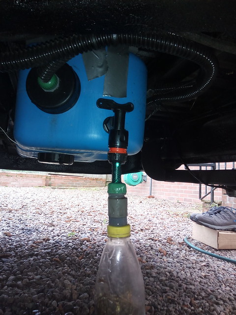

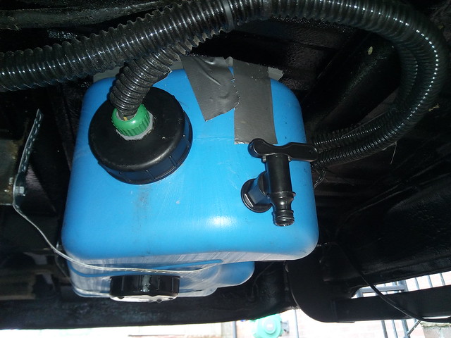

Greyy Tank
by David, on Flickr
Not super low, but it is in strong location and very secure.
The pipe coming out the cap in the middle of the tank is acting as an overflow with the pipe set high so will only flow when tank is full. The Tank can also be fully emptied by undoing the bottom cap.
Went for this simple setup over a custom waste tank for cost purposes - this was under £20 all in.
And can still attach the fruit juice straw filters as well where ground emptying is appropriate
