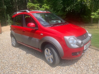

There are a few that I have seen that are converted to tow cars. There is one on ebay at the moment that is a Cross version so it has an electronic diff lock too.

I think the Panda Cross would be a great tow car Phil, my Panda has been no trouble behind me and it doubles as a trailer as well as a car, it is useful at meets or CL/CS sites.
