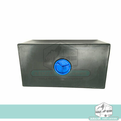

I have one of these - https://amzn.to/2RnsNjf
you could use this as a waste tank. I got this from a forum member for a charity contribution if I recall right, but never used it in the end, so would pass it on on the same basis. But if your user name is where you are, it's a bit of a distance (I'm in Scotland)
Have you sneaked into my garden and taken a photo? that is just what - and where - mine is :D

I can see waste water tanks on ebay but not specifically for a transit. I was thinking the ones in the kits were made to fit the space thats there beside the fuel tank and may be a bit bigger than a standard waste water tank. Like my fresh water tank which fits the space its in quite tightly.
Looking at the one above I might just order the Bissett tank i can fit in the space
