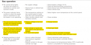

Symptoms - after switch on, runs for 20 secs. There's a click as the gas valve opens followed immediately by another click and the red light.

Sound like what I got with mine once and that was low volts, you turn on, it runs the fan to purge the system, then a click as the solenoid/s open the gas valve, then a click and a red light, I went to Truma in Derby twice, they ended up putting a new PCB in but that didn't work either, it's 12 years ago and I can't remember what the actual fix was but a temperature sensor rings a bellHello vanity, can you help me with my trumatic c 6002. I have the problem that you described it doble click and then turn red.
I tried today for the first time to run in winter mode without water in the heater, I ran for 10 min and click for trying to make hot air, and suddenly it shuts down with the red lamp. And know i can hear it turn on and open gad value and 1 click first and 1 click after.

I have checked there is no lov voltage.Sound like what I got with mine once and that was low volts, you turn on, it runs the fan to purge the system, then a click as the solenoid/s open the gas valve, then a click and a red light, I went to Truma in Derby twice, they ended up putting a new PCB in but that didn't work either, it's 12 years ago and I can't remember what the actual fix was but a temperature sensor rings a bell
Different heater so not relevant but it was inside the cover, and it was an overheat sensor so not your issue probably.I have checked there is no lov voltage.
What temperature sensor did you replace ?
