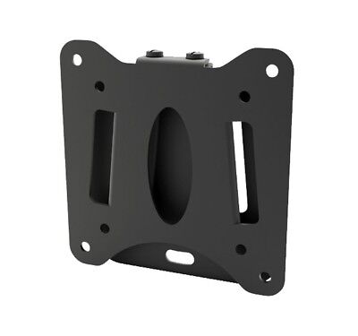

Is there not a reinforced area intended for fixing a tv one of those pull out swivel mounts is going to put some strain to where ever its fixed I use a 2 piece slide mount keeps tv flush to wall
Hi, the 4 mounting holes in the back of your TV comply with the VESA mounting system. You measure the distance (in mm) between the screw holes vertically then horizontally and buy a bracket that covers these dimensions. Most brackets cover a wide range of VESA sizes, eg you'll see like 200 x 200, 200 x 300 and so on. Bob
The TV I am using is 6kg, probably no more than 1kg heavier than a purpose built caravan TV
The holes on my TV are 3 inches apart which seems fairly standard.
All the images I've seen on Goggle indicate most brackets have added holes presumably to fit a range of TV's
If your holes are 3" apart vertically and horizontally then that will be 75 x 75 - that + 100 x 100 is pretty common VESA size for smaller tv's
