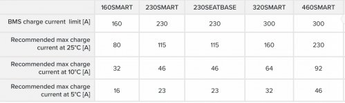

Roamer helpfully give recommended charge currents for different temperatures. I suspect they would apply to other Lipo batteries too.
And that data shows that the zero degrees cut off is a complete fallacy. NOTHING happens at zero, there's no cliff edge or line in the sand at zero or anywhere else for that matter it just gets more harmful as the temperature gets lower. The chart shows how permissible charge current gets less with temperature but there's a third factor that's not widely known or talked about yet and that's the battery's state of charge, it's permissable to charge at low temps and relatively high currents providing the battery is in a relatively low SOC.
Jumping in your van and driving it at 5deg C with a high current B2B could be OK if you're batteries are well below fully charged, however if they're already sitting nearly fully charged then you'll probably be damaging them permanently.
