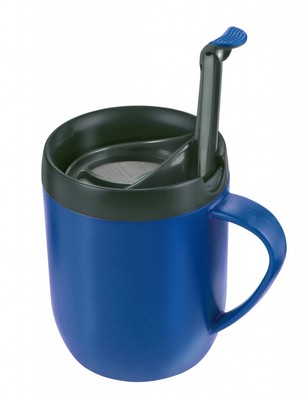

You could do worse than one of these...
I enjoy a cup each morning, two heaped spoonfulls of your favourite ground coffee, add boiling water to the level you want. Give it a good stir. Let it settle a minute or two, give it another stir then put filter into cup... all typical cafetierre stuff, but now just press plunger down and drink it direct. Even comes with a lid and stays hot for ages.
Gets my vote as fuss free and easy on the batteries
