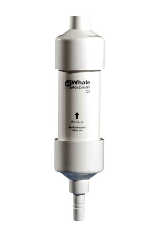

Fitting an accumulator might be a solution.
The following links are for background information and in no way recommendations as to suitability:
Thanks TBJi
Something to look into. As this problem hasn't occured in the last sevenish years it appears to be more a fault with something more than an inbuilt fault.
