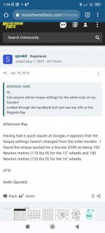

Think I may have found the answer using Google, unbelievable that fiat do not give you the information in the hand book.
Screenshot_2022-11-28-07-59-47-310_com.android.chrome.jpgScreenshot_2022-11-28-08-03-37-601_com.android.chrome.jpg

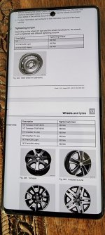

The Alloy wheels are set at a lower torque. Burstner manual has settings for each type and size of wheel. I'll look it up and edit thsi post in a wee while.
EDIT: 15 & 16 inch Tomason & Imscher IC-Line Alloy 180Nm; Fiat X250 Light Alloy 160Nm; Fiat X250 Heavy Alloy 180Nm. Photo attached of Pages 216 & 217 of Burstner Manual

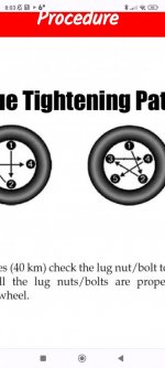

Remember when tightening to do it across the face and in 2 or 3 steps, dont tighten one at a time and put some water proof grease on the threads, whell backing, quicksilver 24c prop grease works well.24c grease.png
