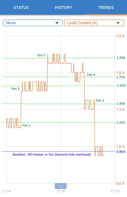

I thought I would provide a bit of info on how much power the fan on a Truma Trumatic S3002 (a very common Caravan/Motorhome) heater might use when running on gas but using the fan to distibute the heat ....
5 Fan speed settings in manual mode. the screenshot below with added info shows how much current each fan speed pulls over the general baseline current of 0.95A
Truma_Fan- Power
by David, on Flickr
Fan Speed 1 - 0.3A
Fan Speed 2 - 0.5A
Fan Speed 3 - 0.7A
Fan Speed 4 - 0.8A
Fan Speed 5 - 1.0A
So say you have the fan on the middle setting of 3 for 7 hours ... you would take 5Ah out the battery.
Truma_Fan- Power by David, on Flickr
Fan Speed 1 - 0.3A
Fan Speed 2 - 0.5A
Fan Speed 3 - 0.7A
Fan Speed 4 - 0.8A
Fan Speed 5 - 1.0A

Similarly with the fan on a Truma Trumatic.... taking 5AH out of a battery in 7 hours is noise compared to other loads such as a TV (5AH within an hour) for example and within the capacity of any likely battery fitted to a Motorhome.
