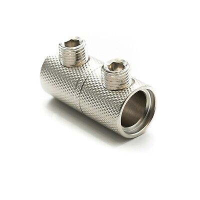

I remember when I did my first camper, the split-charge cable ended up being around 6" or something too short. So frustrating and what a faff it always is to join heavy (or even heavy-ish) cable.
Ever since then, I err on the side of excess and usually end up having to chop a couple of metres off each length once routed. It is far easier to make a cable shorter than it is to make it longer!
