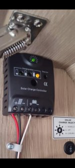

It has a fitted solar panel.which has a cheap solar regulator which you have to switch manually between eg or lb.(charging)

The factory fitted solar charging system is 100w panel a cheap regulator .which you manual switch between eg and lb.
I would change that to mppt dual and get rid of the manual switching.

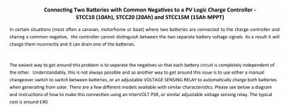

Not seen that controller before and it looks quite good. I like this feature:
Whether charging two leisure batteries or a leisure battery and a vehicle battery, the MPPT Pro concentrates power solely on the battery connected to its No 1 terminals until that battery is 70% charged and thereafter provides a simultaneous and equal charge to both batteries.
That looks a big improvement on the usual MPPT Duo Controllers.
However, reading about installing the controller, there is a major 'gotcha' and I don't understand why they have come up with a controller that, based on their advice, cannot be used in the great majority of motorhome and campervans :unsure:
See the link on their website here - https://www.solartechnology.co.uk/c...Charge Controller - Common Negative final.pdf
Your new van will have a common negative between the two batteries. Their workaround in effect converts the dual output to a single output with an external control that you could add to any solar controller. I don't get it :rolleyes:
Hi Mike....the P V Logic manual states there should be no connection between Batteries 1 and 2....which would rule out use of a B2B.
I would point out the poor existing installation....wire sizing to battery (brown wire) appears to be 1.5 mm....which after passing through a switch and then all the way to van battery would result in a voltage loss on nearly 2 volts!....Alec.
Hi Alec autotrail wire are poor ..
