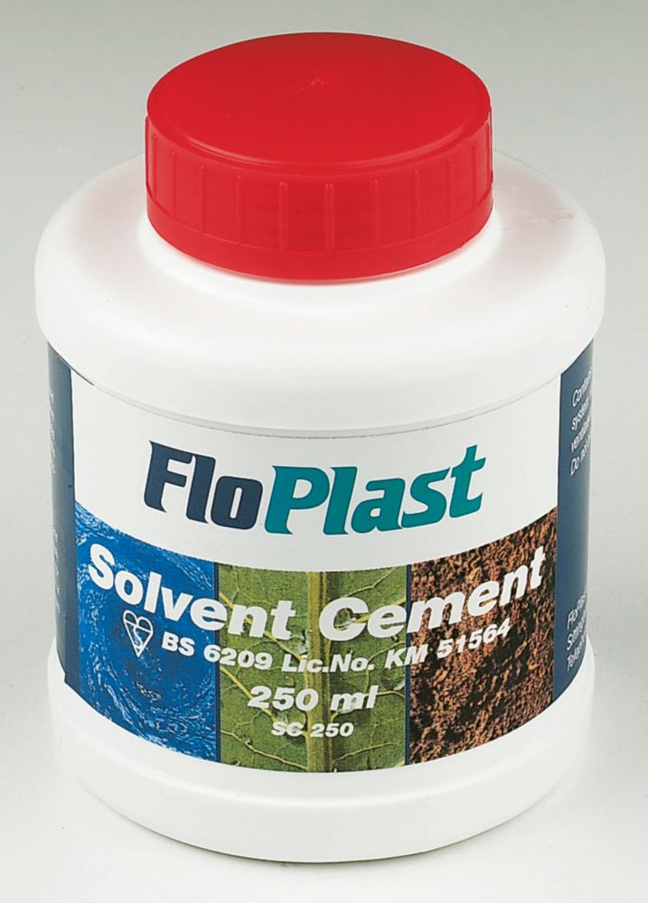

I find that solvent cement sticks a lot of different plastics well
Solvent weld works really well on 'some' plastics... When it's a socket type joint (large surface area for it to act on)
Not much good on a butt joint...
To be honest IF it's anything that takes any sort of stress....
Gluing will likely be a temporary fix at best...

If it’s anything like almost any non brittle plastic I have tried to glue, it won’t work. It looks like polyethylene.
You could try drilling and pinning the two parts together or make a steel plate to screw over the join, then use something like araldite ( other epoxy glues are available, but probably not as good!) to hold it all together.

It's certainly not polystyrene: solvent weld glue doesn't touch it.
I've ordered some glue that claims to stick "most hard plastics such as rigid PVC, acrylic, polycarbonate and ABS" I think that drilling and inserting pins and maybe a small stainless steel side plate might be a smart way to boost the strength.
