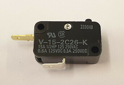

Hi I had a Shurflo diaphragm pump on my Euramobile. The pressure micro-switch in the base of the pump went faulty - sticking "on". I did change the micro-switch (very cheap) and this lasted a while before same happened - it seemed that as the pressure built it was just not enough to operate the switching contact and was in reality a problem in the pressure side of the switch not the electrical side. New pump sorted it out.
Check out the operation of the wee micro-switch - you can get these on Ebay. You might get away with the easy fix before committing to new pump.
So what I am saying is your micro-switch is stuck on and not cutting pump off after pressure is reached (normally 5 seconds or so).
