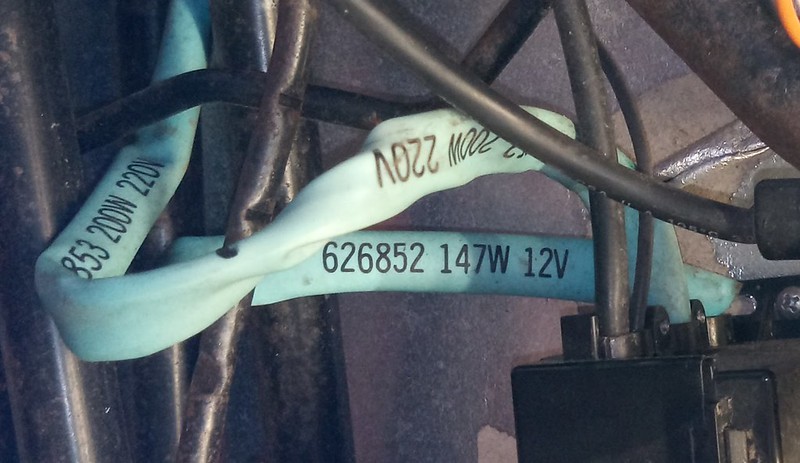

Your 2007 Thetford is likely the same power setup as the Thetford fitted in my 2007 Model Year Motorhome?
Took this photo of the electric circuits ...
Thetford 3-Way Electric Power
The 12V element is 3/4 of the power of the AC element, which will make a noticable difference.
