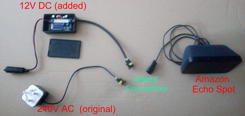

The approach I took when I adapted my Amazon Echo to work on 12V instead of 240V is the following:
  1. Cut lead between 240V adapter and jackplug
  2. Fit a connector on each end of the cut wire (so they can be reconnected again). I used these - https://amzn.to/2Ywlfwi - but lots of socket and plug combo styles around
  3. Fit another to the output of the DC Adapter you are getting
You can then just switch between the 240V adapter at home and the 12V adapter in the Motorhome by swapping the source plugs over. This saves trying to find a matching jackplug from the myriad of different sizes.

Thought I would add a photo to illustrate what I was talking about ....
IMG_20190705_192127 by David, on Flickr
