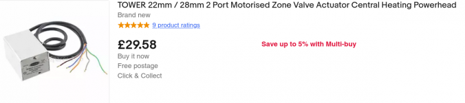

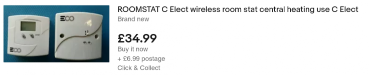

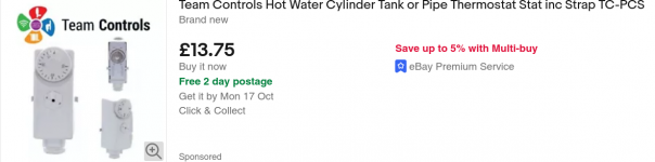

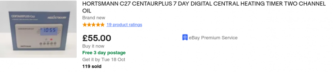

Something wrong there if your boiler has a 3 pin plug on it, it should be wired through the motor valves and control unit back to the fuse box, how would the living room stat turn that of, time to get a proper heating engineer in.heating valves.pngprogrammer.pngroom stat.pngtank stat.png

The stat on the boiler is an emergency over heat stat, there is a second one inside the gray box incase the main one fails, these should not be used to control the heat in the house, and how would they know what temp the living room is at, get the mates to sort it out proper, and old sys like your set up was banned from 2007 and should have been upgraded from then, mind you no one seems to check this here as 90% are ill fitted.
Trev, I had my system designed to meet the needs of my 250+ year old home, which has three floors. I can isolate each floor CH pipework, for example, if I need to remove a rad on ground floor, I isolate floors two and three, then drain ground floor only, and as you will know, I can isolate the individual rad being worked on without draining every ground floor rad.
Thermostats are normally located within a hallway, my heating would never be off if I had a stat within hallway, which is large and cavernous over the three floors. System was designed to work via TRV's, and use of boiler stat. And as boiler is outside in my boiler house ( I use to have oil ) pump, motorised valves, water filter, are all within boiler house, easy to maintain, with no mess in house when being serviced, frost stat also in place.
My system was planned out by an expert gas system engineer, it was he who stated, due to unique layout of my rooms over three floors, it would be difficult to place a room stat, which would/could leave other rooms cold when room where stat would is located said no heat required. TRV's work well for me.
