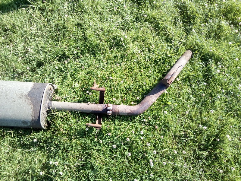

New centre silencer ordered but as it was only supported at the end of the back pipe now I decided to remove the old one in the middle of a rugby field in Redcar rather then risk the front bouncing down and ripping off on the 120 mile drive home and causing any damage to my vehicle (or other road users!)
And when removed I saw the short rear pipe was also a bit past it with the rear hanger being repaired previously and bits of the metal showing distinctly crumbly areas, so need to find a new rear section which is proving a challenge (think maybe the standard pipe is rear exit and mine was a side exit option due to having a hydraulic wheelchair lift fitted originally?)
Thinking I might have to either:
a) revert to a long rear exit pipe (but do I have the hanger mount? maybe removed when lift fitted? and also have a small grey water tank fitted where the lift partly was, so could foul?
b) get a section of pipe fabricated? This might be the best option as the pipe length is so short it shoul be easy to do and could make a support pretty easily I reckon? just the short pipe right of the hanger and bracket here ....

I have got prices of around £75 for that end pipe! I cannot see how a piece of exhaust gauge mild steel of maybe 24" long and 2.25" diameter with one bend can possibly justify a price of £75, especially when the central silencer was £52 delivered to my door?
If need be I will try and source a pipe and a 45 degree angle connector and make something myself

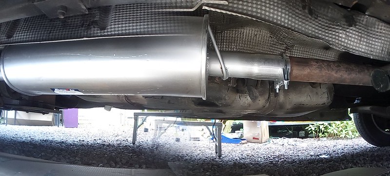

Fitted the centre silencer this morning in readiness for the back pipe and looking pretty good ...
Centre Box
by David, on Flickr
Ran the engine and oh what a difference to the noise!

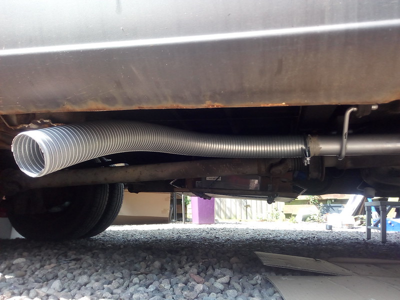

And now have the rear pipe in place :)
Rear Pipe
by David, on Flickr
Used 64mm Flex Tube from Klarius, which is:
"Flexible Tubing Copper Bonded, supplied in 2metre lengths.
Interfolded construction cannot be unravelled by twisting. High tensile strength and crush resistance. Galvanised mild steel"
Seems pretty good stuff. It is slightly oversized for my silencer outlet so used some exhaust paste around the inner pipe and then clamped the outer flex pipe down onto it which should make a good seal I think.
I need to get a larger clamp for the flex pipe so I can secure it near the end to the hanger as well.
Going to finish off the job with a trim piece at the end to make it look tidy and jobs a good 'un :p
Total cost will end up being around £120 with all the parts, clamps, tail trim, etc, so not too bad really. I should call someone like Kwik-Fit to get a quote to compare but I reckon saved around £100 compared to just dropping in to a exhaust centre to get the work done. (and I also have around 1.2M of quality flexible Pipe as well spare. Anyone need any? ;) )
