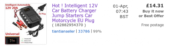

Go for loach lead carbon, many van factory charger are junk, i would tend to buy a good smart charger, i use a numax auto/smart but there are others cheeper on ebay, from £20 to 50, have you no sollar panels to charge batts up.12v 20a charger.png

Go for loach lead carbon, many van factory charger are junk, i would tend to buy a good smart charger, i use a numax auto/smart but there are others cheeper on ebay, from £20 to 50, have you no sollar panels to charge batts up.View attachment 69745
