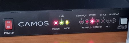

Our Camos satellite dome used to work fine though we hardly ever use it.
The last few times we tried it went through the usual motions and fine tuning but failed to lock on to Astra 1. The satellite select button does not change it from Astra 1 though maybe that is the only satellite available, or is something wrong? After a while the 'lock on' briefly illuminates and it appears to scan for available satellites then settles back on Astra 1 but with gets no lock, this same process repeats every so often.
I plan to measure the signal strength then remove the dome cover and check connections etc. I heard that aging dome covers can weaken the signal, so will test without it on.
Any thoughts?

hi. the first thing you do if its not locking on astra 28E ( english channels ) is try astra 19E or hotbird 13E if then its not locking up you have a problem . you say the finding satellites button is not changing sat's so it sounds to me its the box because its only the box that gives the command to the dome or dish so taking the top of is not your problem you could try pressing the reset button if you have one . our first satellites system was a dome they are ok if its windy but no good after mid France so we went for a 85cm dish . if you do take the cover off you will see why the dish inside is no bigger than a side plate . if it was me i would try & get a replacement like TJBI said give roadpro a ring . cheyenne

I have been in communication with Roadpro. They said that the box cannot be updated. I don't know if another box would work with my dome but am thinking that my dome and box are obsolete? 😪

sorry to here that but technology moves on but it sounds to me that your box is faulty if it would not select another satellite .if you are considering getting a dish go for maxview as you can upgrade it just by downloading on to a usb stick then transfer to your box plus based in kings Lynn .cheyenne
I checked out the dome and dish position box today but no joy. It seems that the dome would need a replacement chip and a new control box for it to work. We barely ever use it anyway, so I removed that big ugly dome from the roof, it was very easy to do, just a few screws and no holes to seal. If anything we would likely just get a portable dish kit if we ever felt the need for sat TV.
