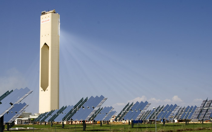

Now that the cost of
solar panels is falling rapidly, it's generally considered more cost effective to install more panels than mirrors - unless the installation is highly specialised and there is no other technical solution.
There's a huge system using mirrors in Spain where an enormous array of steerable mirrors focus sunlight onto a 'furnace' on a tower. It can be seen from kilometres away and as I cycled past it some years ago I was astounded by it:
en.m.wikipedia.org
It should always be remembered that adding any technological complexity (e.g. moving parts, actuators, electronics) to a system adds cost, extends pay-back time, reduces reliability, increases weight etc, etc.
This applies to the system in Spain as much as it does to tilting
solar panels on Mohos. It may be worth doing on a Moho if there's no other solution (for instance the power requirement cannot be reduced and/or there isn't sufficient space for static
solar panels).
