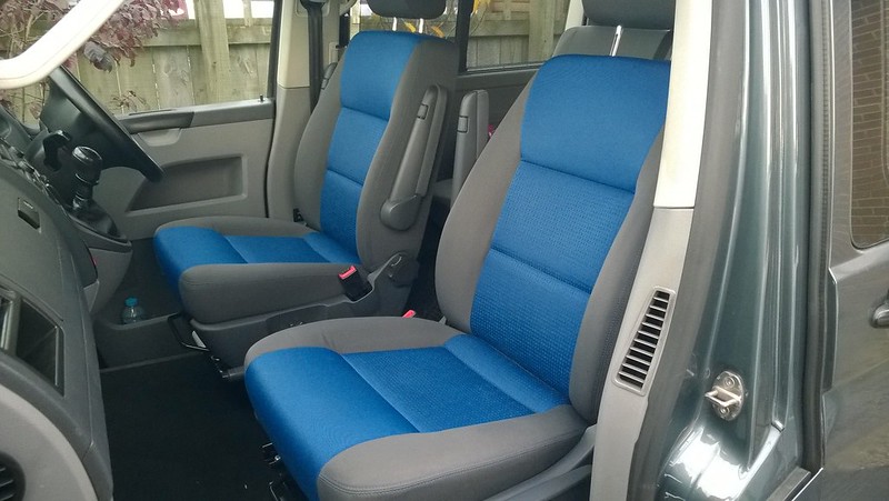

Here's a photo of the seats I fitted to my T5 ...
T5 Seats by David, on Flickr
Just look at the photo and you can clearly see you can't just take the seats off and swap them ... The Seat receivers, the moulding around them, the seat adjusters, the lumber adjustment, the side airbags (and maybe other things as well) all need to be dealt with.

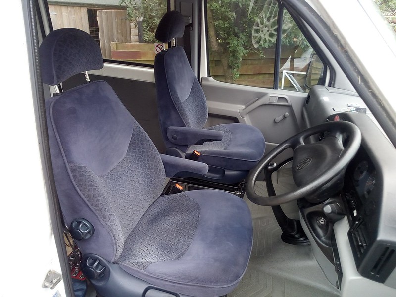

Seats I fitted to my VW LT (Sprinter Mk1)
LT Seats by David, on Flickr
Armrests would go to wrong side, the swivels would go in the wrong direction, the lumber support would go to the passenger. (but at least the belt receiver might be able to be moved easily?)
(FWIW, I dumped my LT Drivers Seat (which is the same as the Sprinter seat) and fitted the Seats above which are from a Ford Galaxy. Much much nicer :) )
