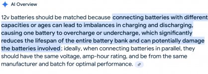

if you like AI info for advice, this might also apply:
When combining lead-acid batteries, it is important to match them as closely as possible in terms of capacity (Ah), voltage, age, and type to ensure optimal performance and longevity.
If lead-acid batteries are mismatched, several problems can occur:
  1. Uneven Charging and Discharging
    • Batteries with different capacities will charge and discharge at different rates, causing some to overcharge while others remain undercharged.
    • Overcharging can lead to excessive heat, gassing, and water loss, while undercharging can lead to sulfation (the buildup of lead sulfate crystals), reducing battery life.
  2. Imbalance in Voltage and Internal Resistance
    • Batteries with different voltages or internal resistance will cause an imbalance in the system, leading to one battery working harder than the others.
    • Higher-resistance batteries may not provide adequate power, while lower-resistance ones may take on too much load.
  3. Reduced Performance and Lifespan
    • The weakest battery in the group will dictate the overall performance of the battery bank.
    • A degraded or lower-capacity battery can drain power from better batteries, shortening the lifespan of the entire system.
  4. Potential Safety Issues
    • Overcharging and overheating can lead to thermal runaway, which may cause battery failure or even fire in extreme cases.
    • Uneven charge levels can cause electrolyte imbalance, which may lead to acid spills or excessive gassing.
Best Practices When Combining Lead-Acid Batteries:
  • Use batteries of the same type (Flooded, AGM, or Gel).
  • Match batteries in capacity (Ah), voltage, and age.
  • Ensure all batteries are in similar condition and state of charge before connecting.
  • Use proper wiring techniques (e.g., balancing charge/discharge paths).
But AI is only as good as the information available to it
AI would carry more credibility if it attributed the information given to respected sources. I donā€™t necessarily disbelieve what it says and the knowledge might be sound but equally some of it might just be popular opinion which can be wrong. Hopefully as AI matures it will start to acknowledge itā€™s sources and provide links.
