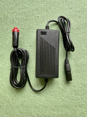

Ah, I see Tom, I already have a mains and a dedicated 12v plug in charger for the scooter, so not needed really.

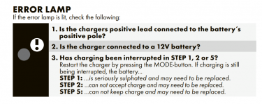

2nd CTEK to die? They are generally quite good. I actually got a refund from Amazon on my CTEK MX-5 Charger as it failed after 2 1/2 years (3 year warranty then). But I did find it outside under a couple of feet of snow at the time it stopped working so maybe not the chargers fault?Yes I came to that conclusion all by my own for once David, so plan B.
Let gravity roll the van back so I can get to the bonnet lever, use the booster pack to start it and then drive over to Alpah batteries and see what they say.
But why didn't the Ctek keep it charged up though? this is the second one to die on me.
